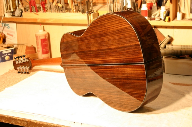

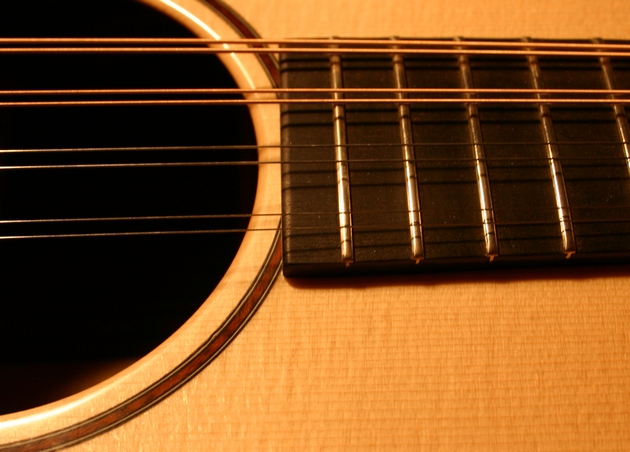

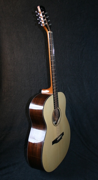

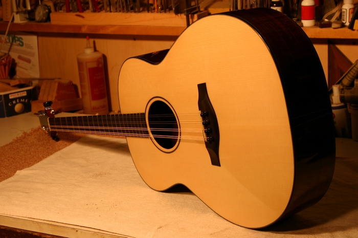

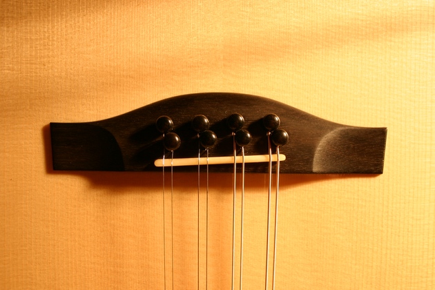

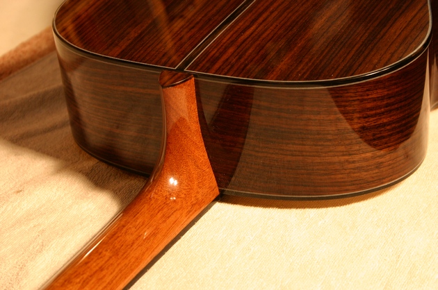

Here is a guitar bouzouki I just finished. Wish I could play it, it seems to sound pretty good!
Italian top, EIR back and sides, ebony appointments. Simple snakewood rosette. Nitro finish.
The pictures are not perfect, especially the pictures of the top fail to show the beautiful grain in this wood. Oh well, here we go.

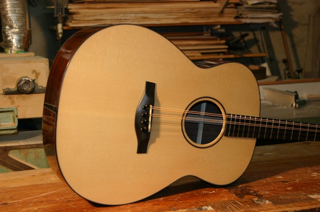

Front:
Another one:

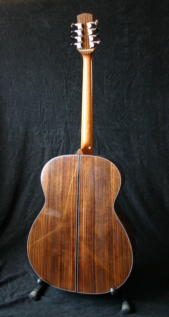

The back:

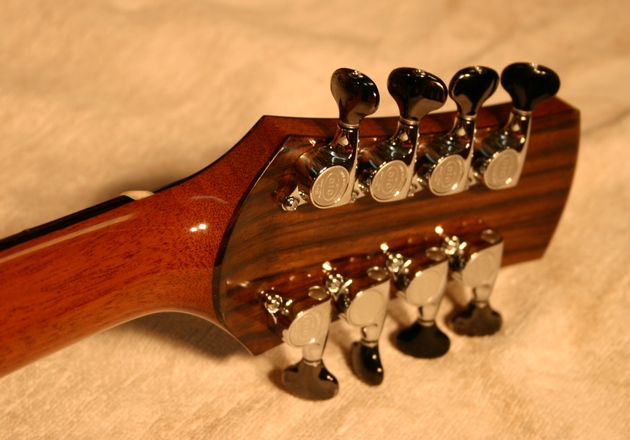

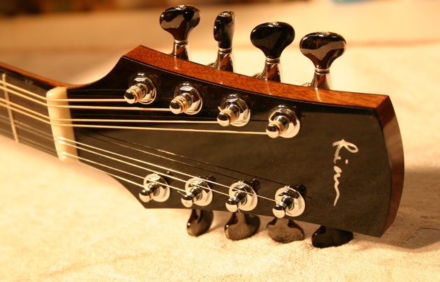

Headstock (oops, I guess could have done a better job of cleaning the dust...):
Rosette:

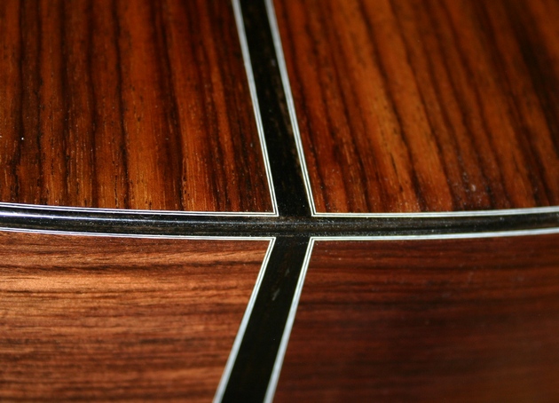

Bridge:

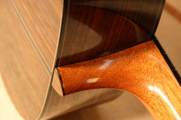

Some heel shots:
And lastly a very dusty one of the butt wedge (!)

Psst! It's an "end graft"!

I just realized I didn't put up any photos of the whole thing, so here are a couple of more.
Front:
Back:
